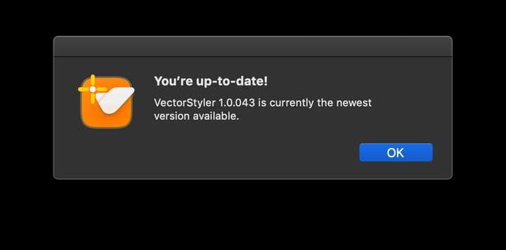

@Buzzer It looks like I cannot replicate this one. I get this notification below.
It could be that something went wrong with the local config.
