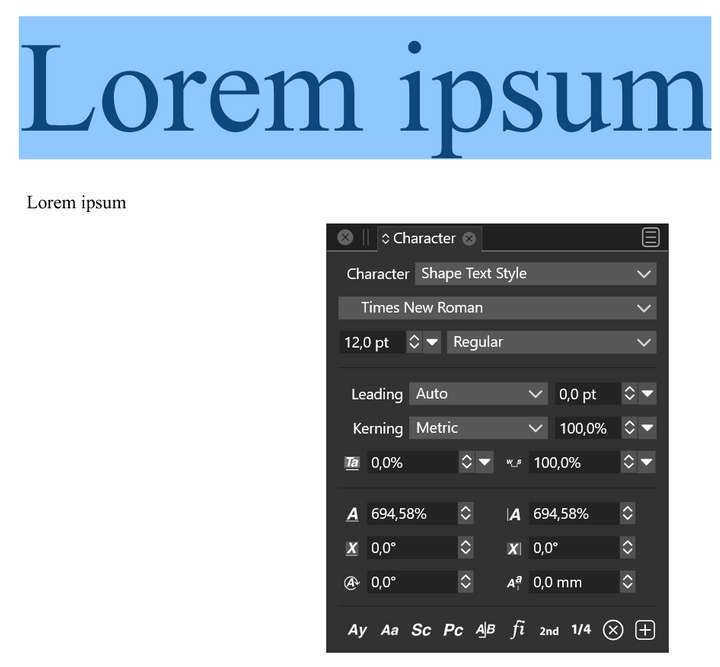

@cjochetz Got the file (thanks!), and now the issue is clarified.
For some reason, the transform tool changed the X/Y scaling factor of the font (see 200% in the character panel, at the A underlined icon).This is a bug, I added it to the backlog and will be fixed for the next build.
About scaling with the Transform panel, in this case shape transform is added on top of the object, so the font size will not change. I will make this optional (to choose between adding a shape transform, or resizing the font).

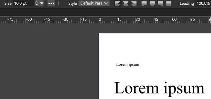

Yes, the first time I place a Lorem Ipsum and scale it, the value stays at 12pt. If I then change the value, every Lorem is then placed with the value I specified, like when you assign a color to a shape, all other new shapes inherit that color.
But it seems VS is getting lost at what value I assign to text at times. In this image, both Lorems are 10pt, according to VS:
The bottom Lorem was scaled up randomly, then I set it to 10pt. The top Lorem is the correct 10pt.

Confirmed! Thank you @vectoradmin! I'm seeing a new odd behavior now, however. After I place the initial text object, then scale, The Character panel changes from the Default Times New Roman to Arial but the font itself doesn't change. See attached.
@cjochetz I keep this issue open.
@Gremriel Fixed in build 1.0.046
