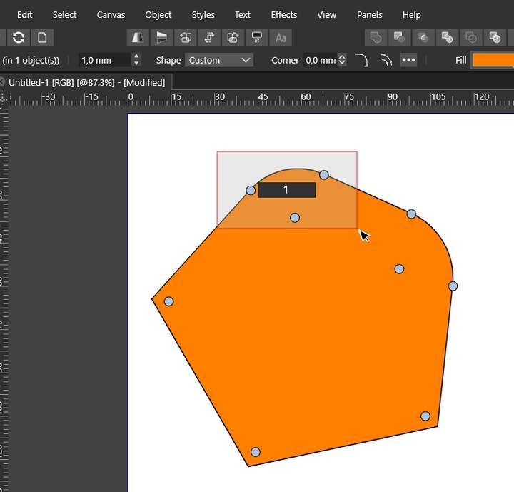

I'm not sure if it's only my problem, but quick select single handle and drag has no effect. Video

PS: Small active area of handles appears in shapes too.
https://streamable.com/joexcz
If the rounding has been made and we want to select this corner by dragging the cursor, we have to select all three points. It seems to me that only one would suffice. https://streamable.com/12z3cy
@encart Box selection of corners is an open issue (not always working right).
I also managed to replicate the issue on Windows (Control+Click is not working).
