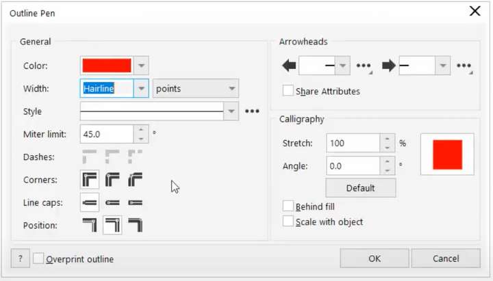

.- With NO OBJECTS SELECTED (required), Click on the Outline Pen (Stroke) Icon in the Status Bar (Bottom of the Screen).
.- This brings up the Outline Pen Options Dialog Box.  Make all the Outline (Stroke) settings you want, including Color, Width, Line Style, Corners, Caps, Position, Arrowheads, etc.  Click Ok.

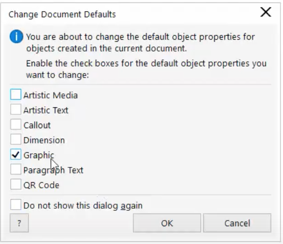

.- This brings up the Change Document Defaults Dialog Box. Choose which Object “Types” you want the change the Default Object Properties to.
.Now all those objects will be drawn, and persist, with these Outline/Stroke attributes for the Current document.

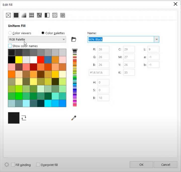

.- Now do the same to change the Fill.  Click on the Fill Bucket Icon in the Status Bar.
.This brings up the Edit Fill Dialog Box. Make all your Fill Attributes Setting choices for Fill “type” (None, Uniform, Fountain/Gradient, Vector Pattern, Bitmap, Two Color, Texture, PostScript); plus Color and Color Mode.
Click Ok.This brings up the Change Document Defaults Dialog Box. Make your selections and then Click OK.
.Now all those objects will be drawn, and persist, with these Fill Attributes for the Current Document.

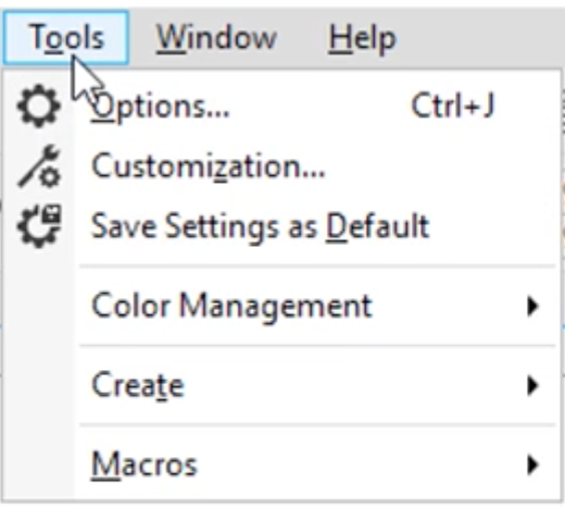

If you want to use these changed custom settings and make them Permanent for all subsequent documents that you create, you can set them as the New Document Defaults using:
Application Menu Bar->Tools->Save Settings As Default.

CorelDRAW terms defined:- Artistic Media — Brushstrokes created with the Artistic Media tool
 - Artistic Text — Single Words or Short Lines of Text that are entered without text frames
 - Callout — callout lines and text
 - Dimension — Dimension Lines and Text
 - Graphic — Lines, Rectangles, Ellipses, Polygons, Common Shapes as well as Grids drawn with the Graph Paper tool
 - Paragraph Text — Block Text inserted in Text Frames
 - QR Code — Barcode objects that represent information in two dimension
