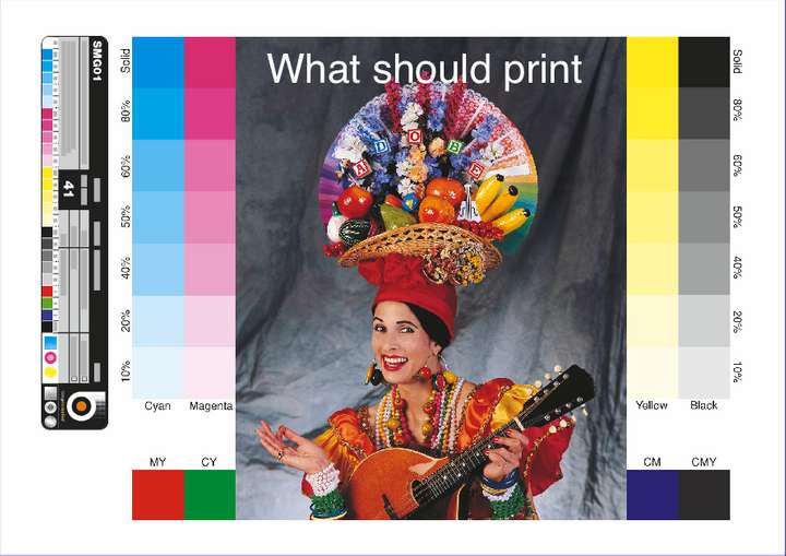

It's a page I've used for years using my own colour bar and the image which I think was a a high resolution version of what used to be bundled with photoshop

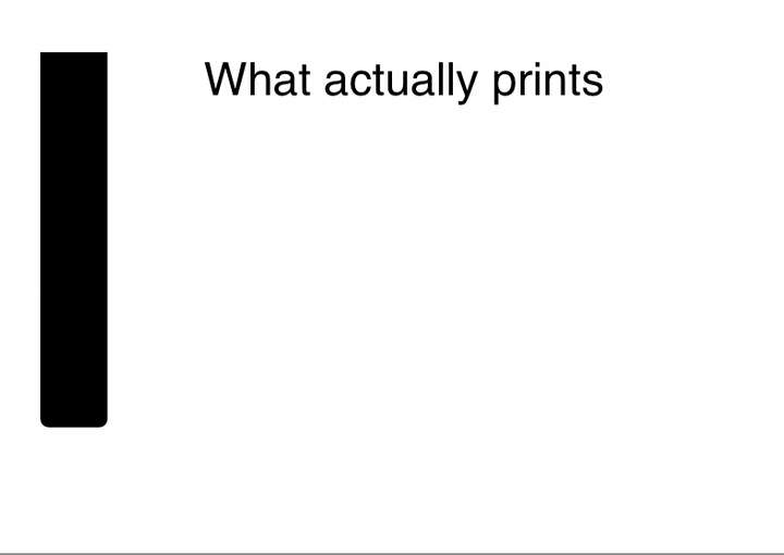

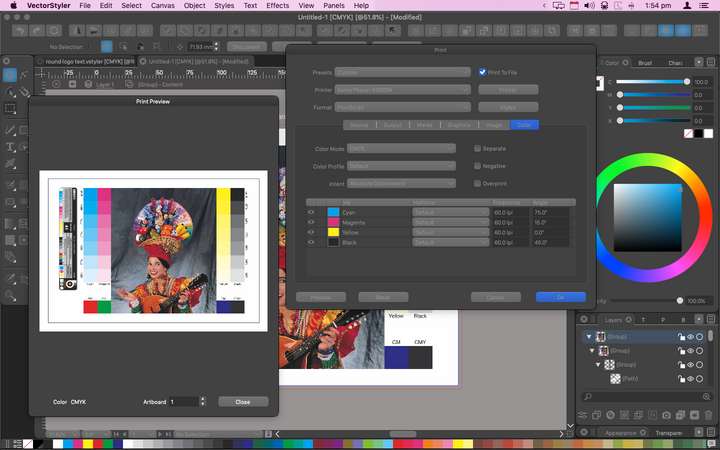

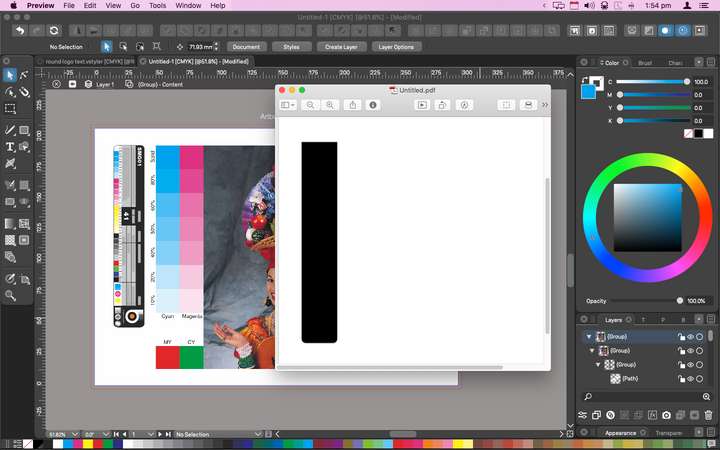

@vectoradmin - really appreciate you giving it a try - I'm on Mojave and still fine with the driver - Guess I'm stuck in Mojave with Acrobat9 for proofing - I also have the exact same issue printing to file via a Xerox iGen 5 press v1.1 driver - the result in the .ps file is the same as what gets printed from the Phaser 6180 just a black fill-in of the colour bar which features on the proof page, no photo or colour information
@Dazmondo I keep the issue open. I also tried on Mojave the same, and the driver did not show in printers.
A question: when selecting "Postscript File" as a printer in VS, can it print correctly?
@vectoradmin no just a black bar where the vector information and text should be - tried using Xerox iGen / 6180DN + EPSON SX435 all the same result :
