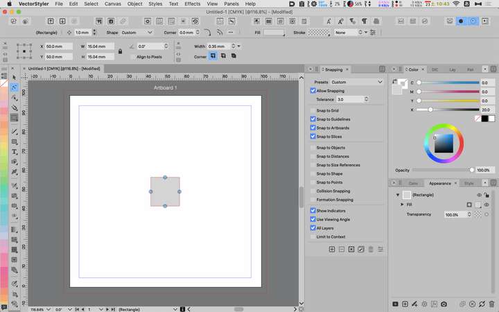

I am using that setting. And there is a feeling that I am Snaping somewhere.
However, if I have other snap options turned on at the same time, it's hard to tell if that's the center.
That's why I also want a snap guideline indicator.

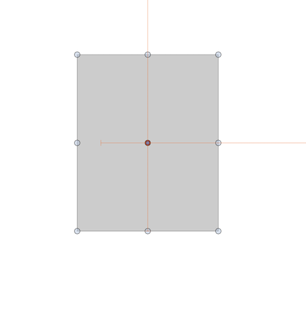

@861475_VctSt When 'Snap to Artboards' is enabled, here the app displays orange guides when the object snaps to the center of the artboard:

I want to move the object to the center of the artboard by dragging it with the mouse.
I want to display the guide indicater at the same time, so that it is attached to the center of the artboard.That's my first post about wanting that feature.
I have received several answers since then, but I can't do it.
I tried it, and I can't get the object snapping to the artboard center either.
@861475_VctSt It looks like there are some issues with the indicator (at least for me), but the snapping works. I will open a bug on this one.
