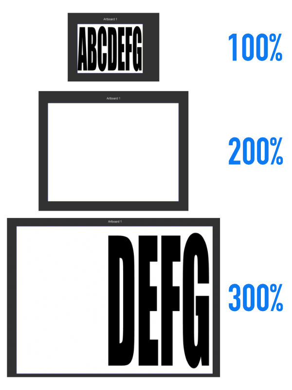

From a design point of view I'm not a fan of stretched text but thought I'd point out this issue out as it might be a problem for some.
When text is stretched vertically and page is zoomed out, all or parts of the text can disappear from view. It can also happen whilst in the process of stretching the text down. It’s ok so far then at a certain point some of the letters disappear. The text is still editable in outline view.
The font used in the screenshots is 'Impact' but it can occur with most fonts.
@Jono What font is that? I will try to replicate.
@Jono This issue is fixed in build 1.0.062
Wow that was quick. Just tried it, perfect thanks
