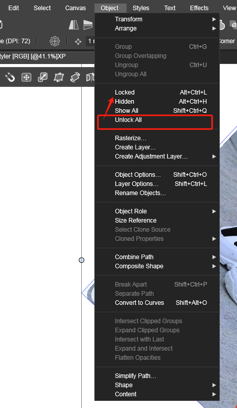

@VectorStyler Move this menu upward, please.
 The red shape is a locked graphic. I tried to align the blue shape with the red one, but found that the operation isn't feasible. This function works in other programs.
@monsterfox I will improve this.
