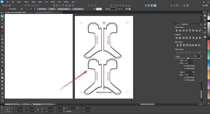

@VectorStyler Cut a shape, create a new canvas, and paste the shape onto the canvas. However, the shape is not in the center of the canvas, and it is hoped that this issue can be optimized.
@monsterfox When pasting, the position on the new artboard is similar to the position on the original artboard, this is by design.
@VectorStyler I'm curious about maximizing the display of the current canvas. Theoretically, it should be in the center of the screen, and when we paste a graphic, it should also be in the center of the screen in theory, but there's a deviation. Most vector graphics software don't have this issue. Being able to paste graphics directly in the center of the canvas would save the subsequent steps of moving or aligning them to the center of the canvas. I still hope this problem can be resolved.

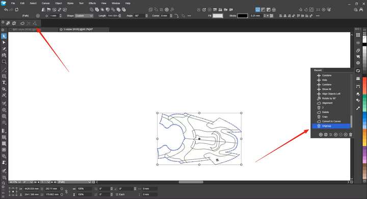

@monsterfox Maybe I misunderstood, but the "Connect Paths" action is added to history, at least here.
A recording might help explaining the issue.What other actions are not added to the history?
@VectorStyler You got it wrong. This is the Recent panel, not the history.
@monsterfox Got it, I will try to replicate with that
